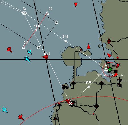

185th VFS is tasked to destroy 2 runway sections at STP 4 (Oulu Airbase) and STP 5 (Raahe-Pattijoki Airbase).
This will incapacitate 4 red air squadrons and should give us a strong hand towards air superiority.
Package 2288
WARHAWK1 is a 2ship strike that will deliver 2xGBU31-V3-AP on a specific runway section of each airbase.
MUDHEN6 is a 4ship escort.
Once this task has been completed, both flights will remain on station at STP6/3 and provide BARCAP until weapons/fuel bingo.
MS is for both runway sections destroyed and no loss to enemy fighters
PS is for one runway section destroyed and 1 loss to enemy fighters.

Escort Warhawk1 to target area, box formation, OCA 20nm trail. Once weapons released, retrograde to setup CAP, Warhawk to NE, Mudhen to SW. Slammer C for everyone but #4, who had Slammer B.
Some minor admin issues including comms channels and datalink distracted from focusing on building SA prior to first engagement. Need to ensure these are addressed early, including a test for D/L while all still on UHF 2 (ground) prior to take-off. This should become part of SOP.
As we entered Western edge of AO box there was a mass of aircraft to our front, red and blue from the Eastern edge of the AO and further East and SE, at least 20 groups.The picture never got less busy during the whole mission.
Engagement 1: #1 detected non-IFF strober group that were potentially hostile and declared on burn through at 35nm, confirmed hostile, 4xSu-30Mkk, 21,000ft. Due to bandits flanking right to left, pushed beyond MAR. #1 fired Fox3 at 25nm and cranked right but missile snipped almost straight away due to bandit jamming. #2 did not get a shot, first element turned cold, bandit splashed. Second element hot but unable to sort due to furball with other friendlies so turned cold. First element now hot again, bandits flanking so pressed to 20nm, Fox 3, from #1, splash. #2 also fired and hit his bandit, splash 3. First element now cold again, 2nd element hot. The remaining bandit bugged out to East.
Engagement 2: Popup Su-30MKK group to South, 2-ship. #3 and #4 originally pressed on Engagement 1 groups but after these were splashed they turned South to engage the new group. Bandits were flanking, they pressed to 17nm, #3 Fox 3 but shot was trashed as dragged out by bandit. #4 pressed to within 12nm before firing at the other bandit, splash. This engagement, within 15nm was too close, even against a flanking bandit. Had they turned hot and fired they would have been within the WEZ no-escape zone. #1 and #2 were now hot. Remaining bandit now to the South turned hot and there was a further pop-up bandit group, Singleton Su-30Mkk, to the East. #1 handed the Eastern group off to #2 and turned to engage the bandit to the South. Both shots were fired at approximately 20nm against flanking targets, both bandits splashed.
Engagement 3 : 2nd element hot again, multiple friendly and bandits groups on Eastern edge of AO box. #3 was getting close with no burn through so #1 directed to turn cold. #1 detected a contact close to #3, unable to ID so pressed, turning to North, bogey flanking to West. Visual ID at 5nm, MiG-29S, Fox 3 but bandit was hit by an AI missile just before #1 missile arrived so bandit was already going down. Missile hit and destroyed the bandit.
Lesson - On two occasions during the flight a leaker got very close to the flights, the first was the MiG-29S, which luckily did not fire at anyone. The second, later in the mission, was an Su-35 that shot down 4 of the flight. Setting an effective meld radar range when concentration on bandits further away is critical to detecting leaker threats, as is keeping radar in an SA mode such as TWS or RWS for as long as possible. This should be practiced and be part of engagement setup SOPs.
