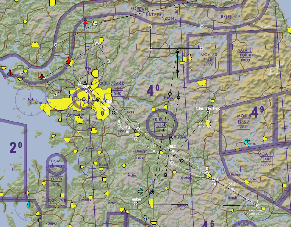

Command has knowledge about several air strikes within the next hours
and we have to protect our airfields and factories.
The picture shows the general situation and the flight paths.
There are two patrol areas: west and east. We will launch two 4-ship
flights for the western area north of Seoul to pronounce it's importance
and the higher number of installations. The eastern BARCAP has to
protect the area north of Chuncheon with two factories and one air base.
Fill the western BARCAPs first and then the eastern one.
Package 23176
Cowboy, Falcon and Fury are a 4-ship BARCAP flights.
Mission success is given for no losses to the flight and
protecting the patrol area,
PS is given for 50% loss max and protecting the patrol area.
Planes w/o ammo or fuel must RTB.
Fury is from the 911th squadron, taking off from Chongju,
Cowboy and Falcon are from the 912th squadron, taking off from Yeonchon.
IDM will be from Cowboy.
Cowboy11 is package commander.

Cowboy and Fury have a patrol time of 48 minutes, Falcon of 46 minutes.
Flight paths are free.
The weather is sunny/fair at home plates and sunny at the target.

Posted - 23 Jun 2017 :  23:28:59  Show Profile Send Floyd a Private Message  Reply with Quote
"protect the patrol area" means that the flight(s) should do their best
to prevent any bandits from destroying friendly assets.
The main problem is to formulate a precise criteria:
- no friendly assets destroyed?
- no friendly air planes destroyed?
- patrol time fulfilled?
- shot down more bandits than friendlies?
There is no strict rule, but the flights will know if they have
won the upper hand ...
Other than that, suggestions are welcome.
