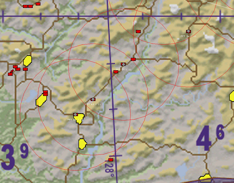

HQ has ordered Mechanized Batallions to the defence in grid 4.6.
The enemy reacted by routing several mobile SA-11 to the FLOT.
They are currently crossing from grid 4.6 to 3.9, heading south west.
The second picture shows possible targets for the SEAD flights.
Due to the increased air thread we also launch two Escort flights.
Plan your flights carefully and use good comms to synchronize your attacks.
Package 15842
