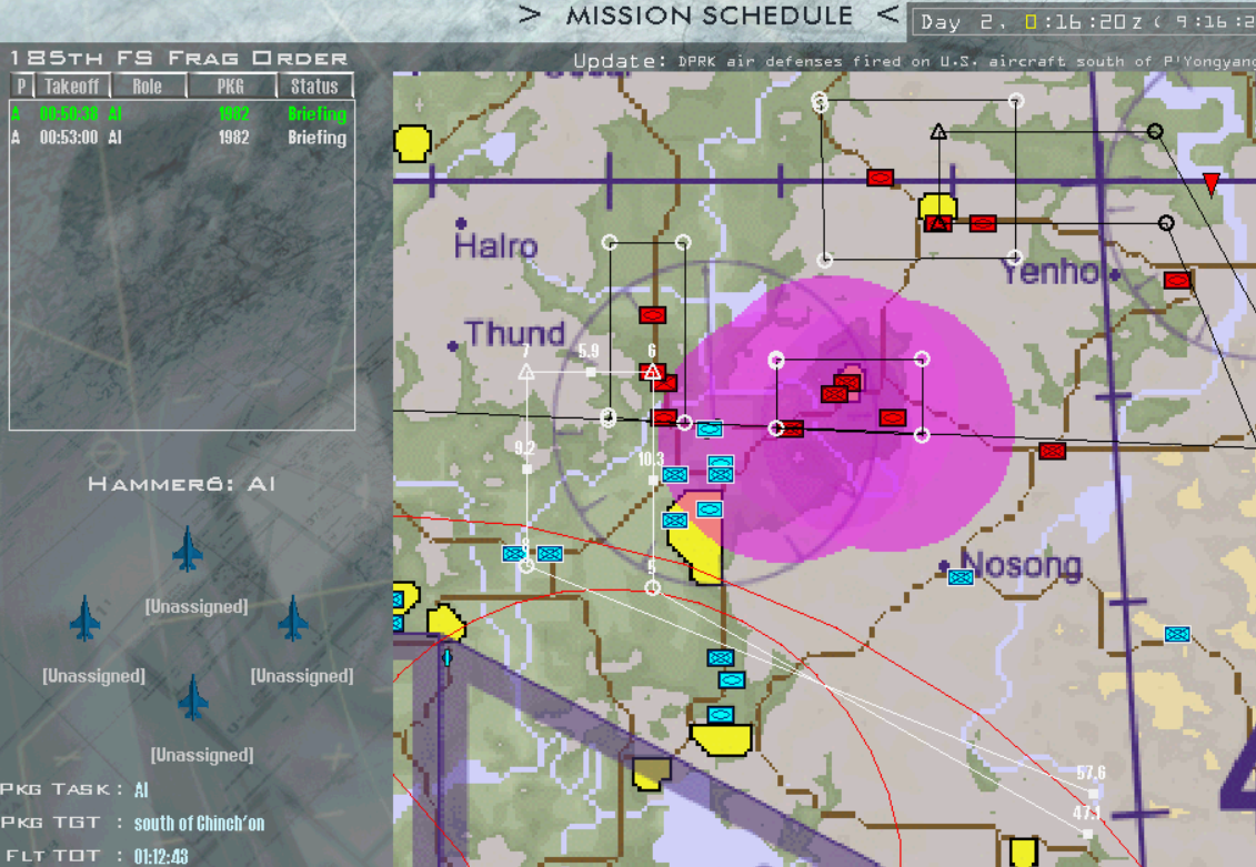

I figured I would write a debrief here so you can all learn a bit about working with a human AWACS using F4RADAR, and how it differs from the AI AWACS we are familiar with. I am working on a guide for using F4RADAR.
I will primarily be responding to your picture/declare/bogey dope calls. Keep in mind, I am not AI, so it may take a few seconds to formulate my reply. AI AWACS will always be quicker off the mark particularly with "declare" calls.
This is an example of what I see when acting as AWACS.
You will note that at this point in time I am only seeing Hammer61 and Cobra51 of the human pilots. I should be able to see all of you, and I am not sure if it is a bug, or lag/performance issue, or just the fog of war.
I can see your heading, altitude (in 'flight level' - first number), and ground speed (second number). The line coming out of the box is the heading and the length an indicator of speed. There are white dots showing the history of position (when available).
Green and red circles are friendly and enemy ground forces. Each circle is a battalion, and if I mouse-over, it gives me the primary unit type (eg: T-55, M1A1, AK-47).
If I have loaded the mission ini file into my DTC, I will see the PPT lines and PPT threat circles (yellow). You can see the FLOT, killboxes, and a couple of Patriot and a Hawk threat circle in the picture.
The blue box on the left is the data table. It has a reference to all the aircraft currently being tracked. Friendlies have all information shown. "Bogeys" have limited information which can change over time. For example, Bogey208 is in the table but not in the current zoomed location of the map. I had seen Bogey208 earlier and at that time it had the ID of "2 x MG29". It is interesting to note that if Bogey208 is ever lost by the radar, when it is picked up again it will still be Bogey208. I am not sure if this is a cheat, or based on assumption from location. Either way, I wrote down on my notepad "Bogey208 = 2x Mig29" so I would know what it was if the ID-type was ever lost (which it was).
You can see in the picture that there are two red aircraft Bogey392. They aren't even in the blue data table, but referring to my notes, I can tell you they are Mig-29s. You can see from the history track that they are a 2-ship that have just split.
I can NOT see if friendlies have engaged hostiles or vice versa. I have to make assumptions on this. It looks like Vulture1 may have just engaged Bogey392 in the picture above. I can see the mission type for friendlies so that helps me know whether they are likely to engage bandits or ignore them. @Fisty, on your way home you asked for declare of a strober between you and the alternate. I could see that it was Caddy4, EWS/EJ, 1 x F18.
